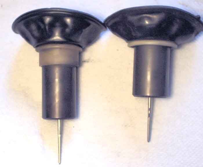

First check if You have the power-reducing carb-valves for 27HP.
Strong power between 6000-7500, lack of power below 7500 revs is typical for the 27HP-version.
look here: http://www.gpz-305.de/Tipps/GPZ-305_Vergaser/valves_b.jpg
